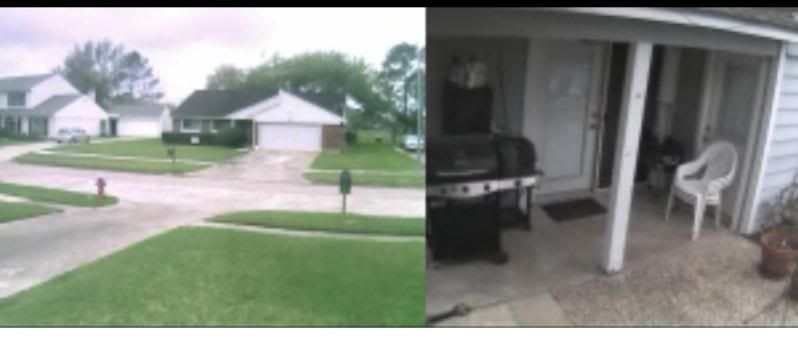

This is using four cameras (three are infrared for night vision) and a Geovision PCI card. It uses up about a terabyte in three to four days, but it's worth it to have solid butter-smooth video at all times (hard drive space is so cheap it doesn't really matter, although I only store four days worth of video). The picture below is from the Multiview part of the Geovision program. Works like a champ!
With my three dogs, alarm and new surveillance system I feel at least a little better about leaving the house unattended. Plus my neighbor behind me is on constant vigil for BG's... and he carries a mean looking Mossberg! :txflag: :fire
