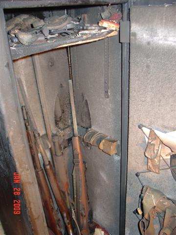

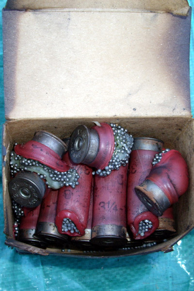

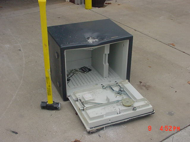

I have been professionally opening, moving, servicing, repairing and retrofitting safes for 22 years now. I do factory warranty work for several major safe manufacturers, and national service providers for banks and commercial stores. I also do the safe work for several other local locksmith companies. Having said that, my opinion on Sentry safes is this: They are well known for their economical "fire safes" which do a very good job of protecting documents form burning up in a fire. If I was looking to protect some documents from fire I would certainly invest in a Sentry safe. Slightly off topic... but for those who do not know... I cannot stress enough not to place a firearm in a fire safe unless it is in a sealed container, or "IT WILL RUST". By fire safe I am referring to a safe which had thin sheet metal walls that are filled with a white powdery insulation. The way a fire safe works is the insulation produces moisture. In a fire it produces lots of moisture to keep papers inside from igniting. I have seen many rusted and pitted pistols that were destroyed by being stored inside a fire safe. If you buy a gun safe that also offers fire protection some have special door seals that expand to keep heat out, and many have sheets of gypsum board as well. It is a good idea to keep moisture absorbing granules or silica gel in the safe, or invest in a dehumidifier.
Here are some miscellaneous images some may find interesting:
Here is an older Sentry that was opened in 16 seconds with "A Highly Specialized Tool" :)
Special Opening Tool
Fate of a Gun Safe
Burnt
Burnt
Fired Ammunition...
Well kind of

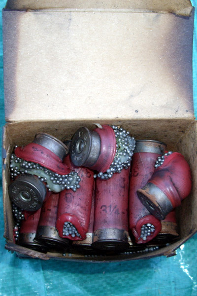

Fate of a Gun Safe
Fired Ammunition...
