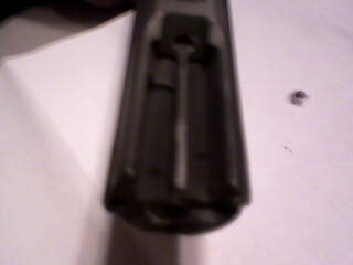

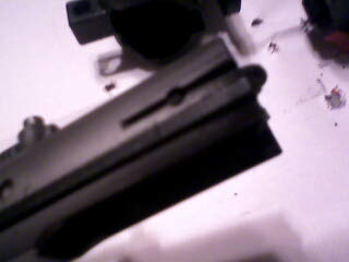

Do you have a picture of the new style bolt? I'd like to compare it to mine...

AJ80
Posts: 238
Joined: Mon Feb 01, 2010 10:37 pm
Re: Had a round go off behind another round with an open cha
Post by AJ80 »
Sure.
I don't remember the exact differences, but it was in the area where the extractor was attached.
Sorry about the bad quality and the dirtiness of the bolt.
I should really clean that thing and then take more pictures.
