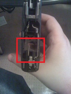

Ok. This is probably a dumb question but here goes. I got a great deal on a gen4 glock 19. I took it apart to clean it, and one of the innards looks bent to me. On my XDM, this piece is totally straight and parallel to the direction that the barrel will sit. On the Glock 19, it bends slightly inward. I've attached a (bad) pic of what I'm talking about. Is this the normal shape for this part, or is this indicative of a problem. Rounds chamber just fine, but I've not had a chance to shoot it just yet.
Thanks!

In my expereince, it's normal for the 9mm Glocks to have that angle to the ejector.
Re: Probably a dumb question about the Gen4 Glock 19...
9mm ejectors are angled that way in Glocks. 40S&Ws are straight.
lkd wrote:9mm ejectors are angled that way in Glocks. 40S&Ws are straight.
All the 9mm's are like that in Glock pistols.

Correct. When I had a 27 (.40) I was going to convert to a 26 (9mm) I bought that 9mm "bent" ejector part, (and the 9mm extractor and spring loaded bearing) so the 9mm case wouldn't whap me in the head as it ejected.NOS wrote:lkd wrote:9mm ejectors are angled that way in Glocks. 40S&Ws are straight.![]()
