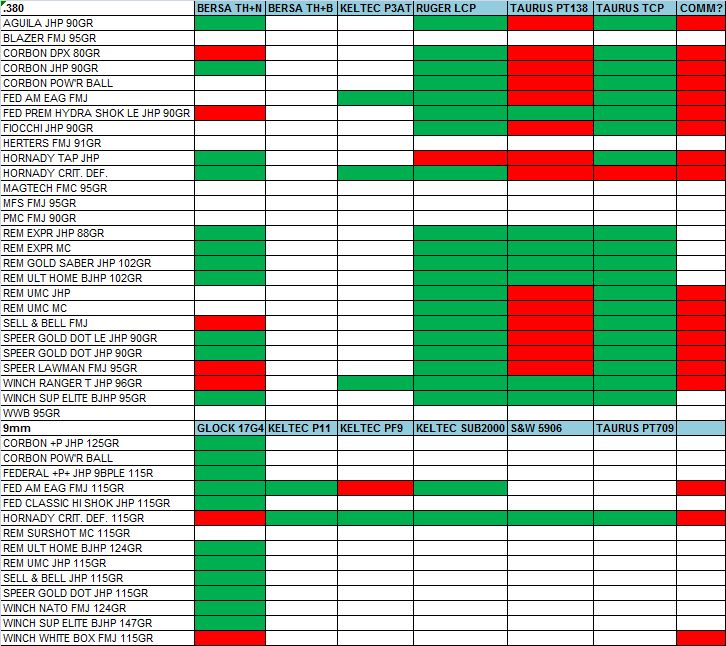

Call me stupid. For decades I owned only one handgun. First a 32 H&R revolver. Next a Beretta 92F. Then an S&W 5906. Then I got involuntarily retireded, and I needed a hobby. Now I have so many handguns I can't remember them all if you challenged me. In last year's ammo drought, I bought whatever I could find to feed my babies. And discovered an ugly fact, to paraphrase Abe Lincoln: "You can feed some of the ammo some of the time, and you can feed all of the ammo some of the time, but you can't feed all of the ammo all of the time." I want to buy ONE .380 ACP practice round for all of my pistolas, and ONE .380 ACP defense round for all of my pistolas. And ditto for 9mm. Attached are my findings so far. Not a pretty sight. For the pistols or for the ammo. Makes me want to go back to wheel guns. But I AM having a lot of fun shooting off my ammo inventory!

Glock can't eat cheap Winchester White box 9mm? :headscratch :headscratch My HK eats anything I tried to shoot, steel, brass, JHP and FMJ.

Seriously not all guns will like all ammo the same. I find for range/match shooting a 9mm round nose bullet works very well. The .380 is usually the problem child I had a P3AT that wouldn't shoot any round nose bullet reliably it would work like clockwork with any hollow point I tried and with WWB range ammo because the WWB has a flat point similar to hollow point. Who knows? :headscratch Every gun is a law unto itself. :rules:

All guns can get picky about ammo, the 1911 is one of the most notorious for that. Typically guns not liking a particular type of ammo can be traced back to the weight and shape of a particular bullet. The OAL can cause issues in some guns, and sometimes you come across weak loads that make a gun not like a particular brand/type of ammo. Often bad magazines can make it appear that a gun doesn't like a particular type of ammo.
Some known issues with some handguns:
1911: Many 1911s are picky about what ammo they will work with when shooting something other than 230Gr. Ball (FMJ) loads. This can often be cured with a magazine change, failing at that have a gun smith work on the feed ramp should fix it.
4th gen Glock 19: Guns with a 03 spring may not properly function with 115Gr ammo. Installing a 04 spring will cure this issue.
4th gen Glock 17: Guns with a 01 spring may not properly function with 115Gr ammo. Installing a 02 spring will cure this issue.

Glock tried to fix a known reliability issue issue with the .40S&W guns (FTF with attached tac light) when they came out with the Gen4 guns. By all reports, they fixed that problem but screwed up reliability of the 9mm guns at the same time.
