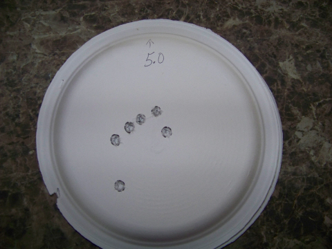

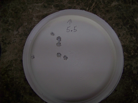

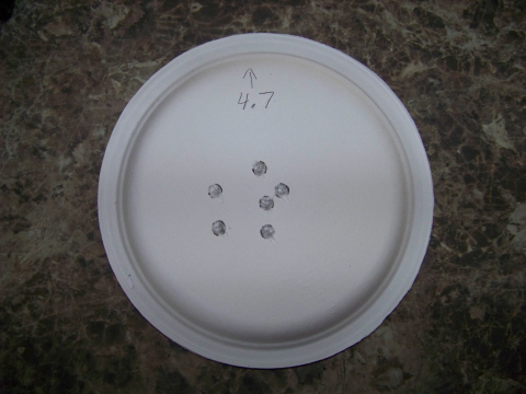

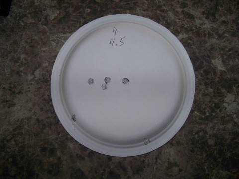

I loaded 6 rounds for each load since I was limited on range time. Started with 5.5 grains of universal, then 5.0, 4.7,4.5, and 4.0 all with the 200 gr lrnfp from precision with the Federal brass small primer. Accuracy with all was good off hand at 12 yards (4 shots), and even decent hiting 12" plate at 30 yards (2shots). Not sure if it was me, but I found the 4.7 grain load to be the best group with no flyer.
The biggest problem I found was with the 4.0 grain load. It left a huge amount of unburned powder everywhere. I had a hand full of it after shooting 6 rounds. So it's definitely out. It also droped one below the plate at 35 yards.
The 5.5 seemed to shoot a tad high, however it was the first group I shot and likely was me and the wind.
I may go with the 5.0 since I feel it is suffiecient to also run in my Ultra II, however I am really leaning to the 4.7 , they were all minimal on the recoil, with the 4.7 just feeling like the sweet spot.

5.5 grains

5.0 grains

4.7 grains

4.5 grains
