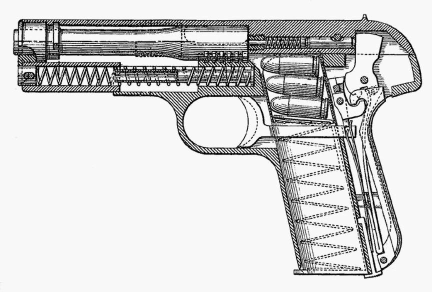

What pistol did Browning design that Keltec miniaturized the 32 acp, friend?
I know Browning's .32 was blowback, with hammer (beside internal), hammer springs more like his 1911 (diagram above)
Keltec P32, 380 below as with other micro pistols I'm talking about.
