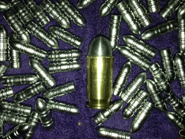

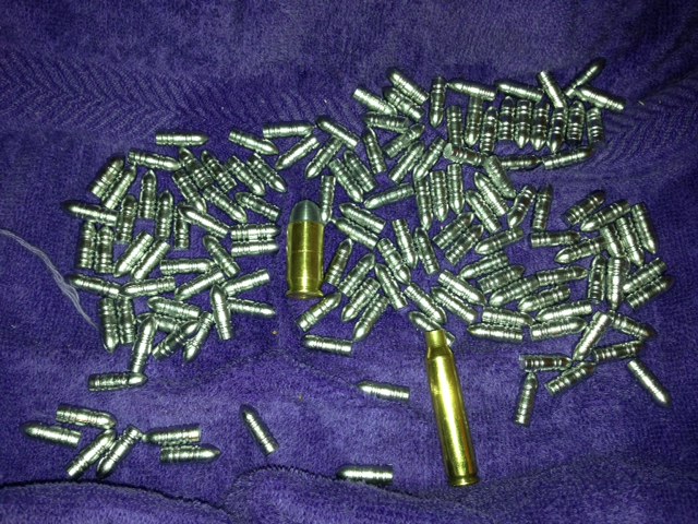

Just got done casting some 55g .224 projectiles.
Anyone ever try these?
I know they wont work in an AR-15, but I will use these in my Savage 24-T. It is single shot .223 and 12Ga.
The Lyman cast Loadbook mentions that these are good up to 2300 fps with a gas check. I will load these up with some 2400 to achieve between 1900-2000 fps.
Should be fun putting gas checks on these little buggers.
