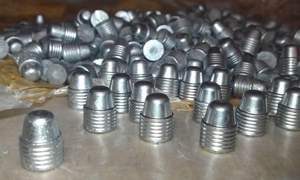

As Andy stated, I'm using a new boolit for IDPA, CDP division. After a year of shooting the 200gr SWCs, I switched to the 230gr boolits. I've found that I have less muzzle flip and more control for quicker follow-on shots. My data is:
Gun: S&W M&P 45 (4' barrel length, .4523 bore diameter)
Boolit: NOE .454-225 RN (sized down to .453)
Powder: Titegroup, 3.9 gr.
Primers: CCI 300
Shells: mixed
OAL: 1.250
Chronographed results- 745 fps avg (CDP 230gr bullet PF=720 fps)
I'll be interested in your findings.

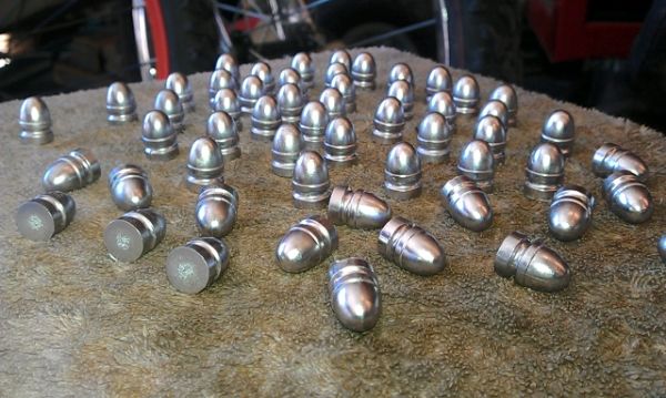

Just for kicks I've added two pics. The first pic is of my old boolit, the Lee .452-200SWC. The second pic is of my new boolit, NOE .454-225 RN.
OLD
NEW
