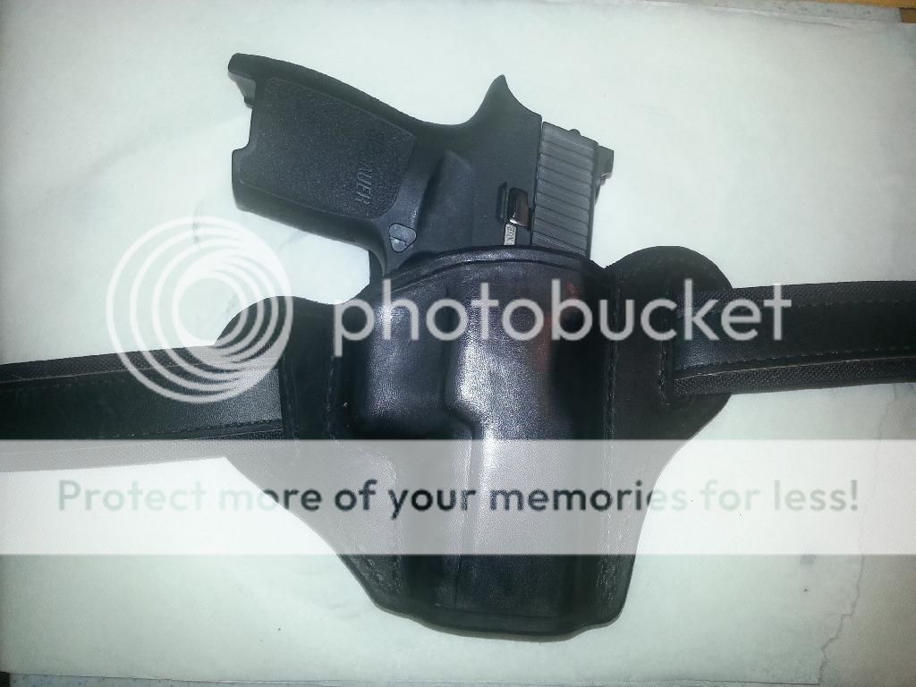

Made this up for my Sig P250c. First holster I have ever made. Messed up on one of the belt loops with the stitching grover. Over all I am happy with it. Retention at this point is very tight, but will loosen up some as all leather holsters do.
Decided to go with black, as the current belt I use is also black.

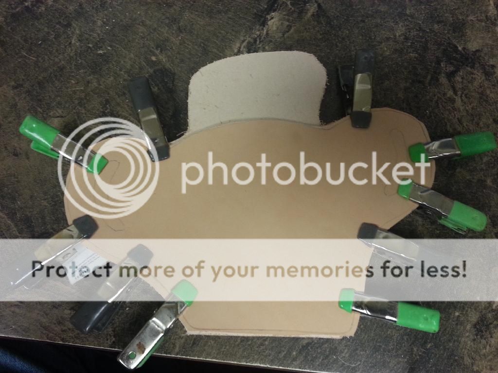

Glued before hole punch and stitching:
Once it was glued, I used a dremel to sand all the edges down to where I wanted them.

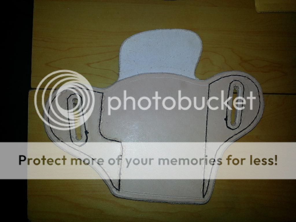

Stitching hole patern layed and punched:

And finally a finished molded holster. In this picture I had not buffed and sealed it yet. Did not get all the definition I was really wanting. But it is for EDC of my concealed carry so not line anybody sees it.
