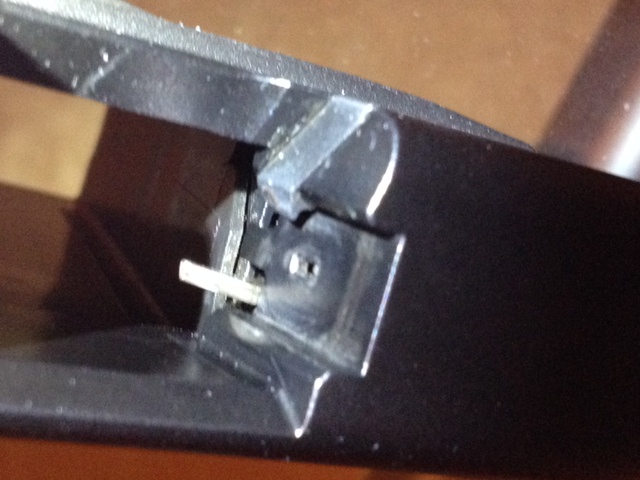

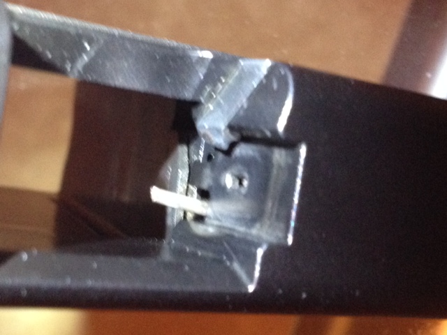

ok so the photos are not the best, but hopefully they're good enough for me to ask this..
Forgive my ignorance, but does the wear shown in the pics here look normal for a Glock 19 (4th gen). In particular, the two areas that concern me are the breechface itself around the firing pin hole and the area to the left/bottom (as you look at the two pics) just outside the ejector.
Thanks!

How long have you had the gun, how many rounds, how often do you clean it, etc? My Glocks don't have any wear in those locations but I keep 'em oiled up and clean after each use. I can't really tell from the photos, but how bad is that wear next to the ejector?

spongeworthy wrote:How long have you had the gun, how many rounds, how often do you clean it, etc? My Glocks don't have any wear in those locations but I keep 'em oiled up and clean after each use. I can't really tell from the photos, but how bad is that wear next to the ejector?
I want to say 3 years now. No idea how many rounds. First year, it saw a lot of action, after that it was just part of the rotation, but has been living in the safe for a while now (6 months). I clean it after I shoot it. I also clean it before I shoot it if it's been in the safe for a while. I have probably used mostly WWB ammo in it.
I'm not sure how to qualify how bad the wear is. It is smooth, no rough or raised spots that I can detect anywhere, just looks odd to me.

Going to say no but I could be wrong. I have a gen 3 glock 27 that has well over 20K rounds and a Glock 20 somewhere North of 7k and the only thing I replaced so far is the recoil spring because I felt like it. Guns ran fine but the 20 was getting a little loose from all the hot loads.

I don't see anything unusual at all in the photos.

Looks fine but remember this is the...

But seriously, I would just give the breach face area a nice scrub with a brass brush and some Hoppes.
I would also completely disassemble the slide and clean all the parts and channels if you are comfortable with doing that. Just don't oil any of those parts as Glocks are designed to run dry.

I am not expert, but it looks normal wear to me. Are you having any failures with it?
