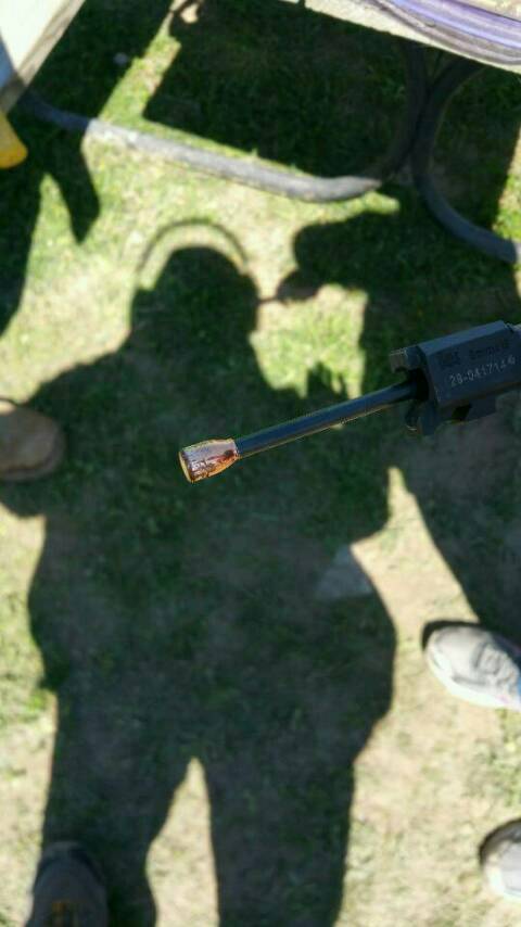

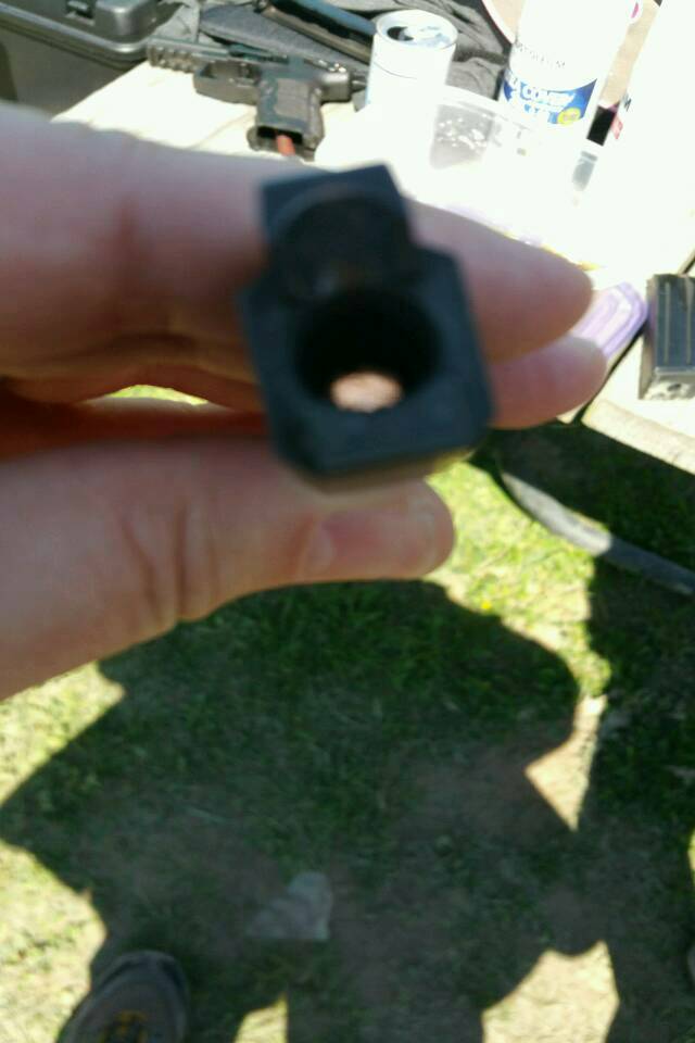

Today my wife and I took a more advanced training course. About mid way through the day my firearm malfunctioned. I tried to clear it and it malfunctioned again. The instructor came over and saw I had an obstruction in the barrel. We disassembled the gun. He had to get a hammer to remove the bullet From the barrel.
What saved me from a much more serious event was the bullet got stuck soon enough that it didn't allow the weapon to return to battery when the next round tried to enter the chamber. Otherwise, I would have fired that round, and bad things could've happened.
I shot the weapon the rest of the day with no issues. I am grateful no one was hurt, and everyone in the class received some unplanned education.

We tried that. My instructor has seen and dealt with this before. It took several whacks with the hammer to get it to dislodge. They weren't hard whacks, but it took increasing force before he got it free. Said he'd never had to use a hammer before.AndyC wrote:I never bothered with a hammer, just tapped the rod firmly against the concrete or bench at the range and kept going until the bullet popped out.

I never heard the pop. We were doing an "up close" drill practicing rapid fire to the body then one to the head. Since we were all standing side by side, and I had guys on both sides of me, the sound of their weapons was loud and constant. I never heard mine pop. I thought it was a misfire so tried to clear the weapon then continue.
What I don't understand, is I thought I had the weapon cleared. During the cease fire after the drill was complete, I looked and the slide had returned to battery, so I thought I was ready to go on the next round of the drill. The weapon didn't fire again. All I can figure is a round didn't chamber when I tried to clear the malfunction. When I tried again (still thinking I had another misfire), the slide didn't return to battery again. Clearly a mistake on my part and not having a clue what was really happening. Looking back, I should have taken a good look at it during the ceasefire but didn't do that.
