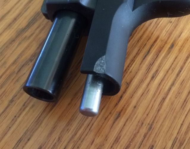

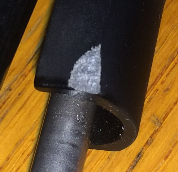

My wife carries a P238 or 239 daily in a Kangaroo carry holster.
In the weekly cleaning routine last night she found a significant area of corrosion on the front edge of the frame, on the side that faces her body.
White powdery in color that fluffed off with a swipe of the finger. There is 1-2 mm of material that has corroded away.
Im thinking this is (galvanic) corrosion.
Sweat, cotton holster, aluminum frame, steel parts in contact.
Its cosmetic only at this point and I'll remove the corrosion, treat, and seal that spot. .. but makes me wonder why it happened on this gun, but not several others she and I have carried in this same holster summer after summer.
Thoughts on prevention?
Repair of the corrosion?
Thanks

If the frame is aluminum then maybe the anodizing was not done properly so the bare aluminum was exposed.
Anodized surfaces are extremely hard and corrosion resistant. Did the gun ever get dropped? 1-2 mm is a lot of material.

I'd get in contact with Sig. Cosmetic is a ding or a scratch, or at least to my way of thinking. That's in the flaw category.
Repair? You'd have to smooth that erosion point and get it coated, otherwise it's just going to accelerate as more area is exposed.
I'd put that in Sig's hands.

The coatings on both the slide and frame should prevent any kind of galvanic reaction. This is definitely a manufacturing defect, and should be handled by Sig. I imagine they'll replace the frame, or the entire gun.

The sharp definition of the damage does indicate galvanic corrosion, but the two metals have to be in very close proximity to do that. Sweat is a pretty good electrolyte.

As an aircraft mechanic, I've seen a lot of corrosion on aluminum over the years. I concur that if the anodizing on the frame were weak (and it does happen) or damaged, it would provide a great place for corrosion to get started. It would still need a dissimilar metal (the steel) and moisture (sweat?) to happen, but I too would place this one on Sig assuming the gun has never suffered a blow on that area that would have damaged the metal enough to break through the anodized layer. BTW, if anyone does have an aluminum frame gun that has suffered a nick or scrape deep into the metal, I would look into repairing it with alodine. Not as good as the anodizing, but still helps prevent future corrosion. Order from aircraft supply companies.
