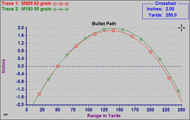

Sandbags, if you already have them, are perfect.......actually a little better than other kinds of rifle rests because, once you've hit the target, your gun isn't as hard to get back on target. As far as 50 yards, that is actually the perfect sighting distance for your M4gery. With either 55 or 62 grain bullets, that will give you +2" above point of aim at about 130 yards, and 2" below point of aim at something like 225 or 240 yards. It's called a Santose Improved Battle Sight Zero. It makes your AR into a "point and click" rifle out to 240 yards........if you can see that far. That means that if you put your red dot on a target, you'll hit no more than 2" high or 2" low all the way out to that distance.
Here are the comparative traces for M855 and M193 ball with a 50 yard zero:
Additional info here: http://www.ar15.com/forums/t_3_18/32814 ... _Zero.html
I am a lot less familiar with .22 LR ballistics, since I never shoot them beyond about 25 yards or so, and I've no experience with .357 in a rifle. But I would think that if you can get it zeroed at 50, you can always move back later and see what your fall of shot looks like and figure it out easily enough.

That is a fascinating collection of detailed information. Thanks! I don't think it works for my rifle, though. I have the shorter barrel, no carry handle. Thankfully, it won't be necessary to figure all that out for my purposes.
I need to figure out the most efficient way to accomplish a modest zero. I thought first about the set up used in
The Box o Truth series, an adjustable platform with a good sized leather sand/shot bag. That is probably superb but likely more then I need. I did some of this back in San Diego with some wooden risers and shot bags furnished by the range, and thought that was a bit ahh, informal. This would be pretty simple if I knew what I was doing, and I appreciate all the forbearance while I try to achieve that.

The carry handle is irrelevant. If you have iron sights, and you adjust them so that your rifle is zeroed at 50 yards with those iron sights, you will still be -/+/- 2" all the way out to 250 yards, with zero at 50 and around 225 yards. How much adjustment is necessary is going to be dependent upon your rifle, the load, the quality of the iron sights, etc., etc. The thing is, it works.
