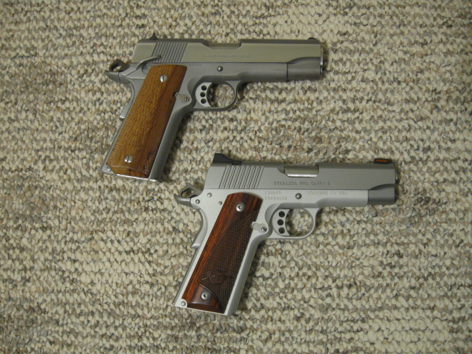

Dear Sweet Wife and I ran some ammo through her new Kimber. All handloads using Montana Gold 124 grain FMJ and Speer 124 grain Gold Dots. 250 rounds total, although some went through my well-used FN Hi Power as an ammo checker.
4.5 grains of Win 231 with the FMJ, OAL 1.161" - some failure to return to battery. These ran fine through my Hi Power.
4.8 grains of Unique with the FMJ, OAL 1.135" - she had a few fail to eject while they ran fine for me. When she focused on tightening her grip they did fine for her too. Similar results with magazines; Kimber mag always locked back the slide on the last round, the slide would return to battery on the empty Metalform mag unless she was paying attention to her grip.
5.2 grains of Unique with the Gold Dots, OAL 1.120" - no failures for either of us.
With the only failures being less than max loads, seated on the long end of the spectrum, in a brand new gun. . . I'm considering this a win. She likes it, and that's a high-priority requirement. I'll shorten the FMJ loads a little and we'll run a few hundred rounds of that through it next.
Here is a, "His & Hers" picture after clean-up.
Enjoy!
Jeff
