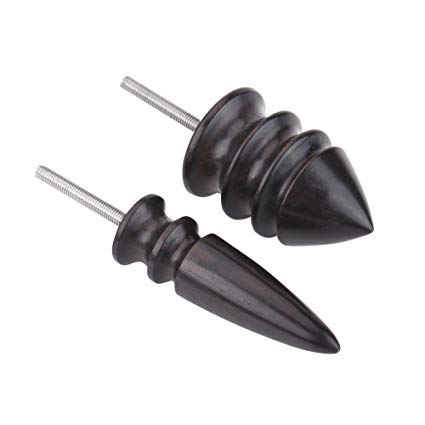

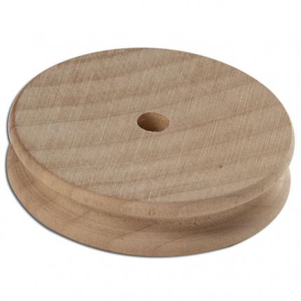

If you don't have one, I recommend an edge burnisher to finish the edges. Available at Tandy and Ebay.

This one is from Tandy.
