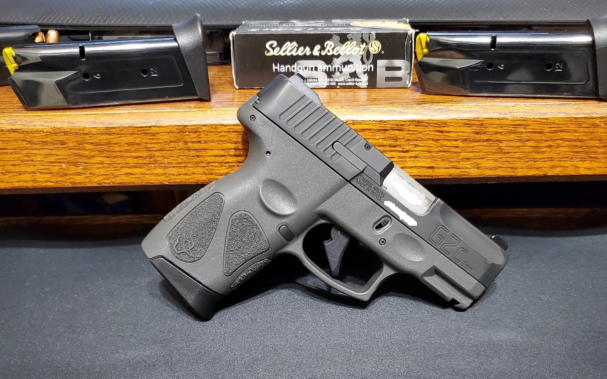

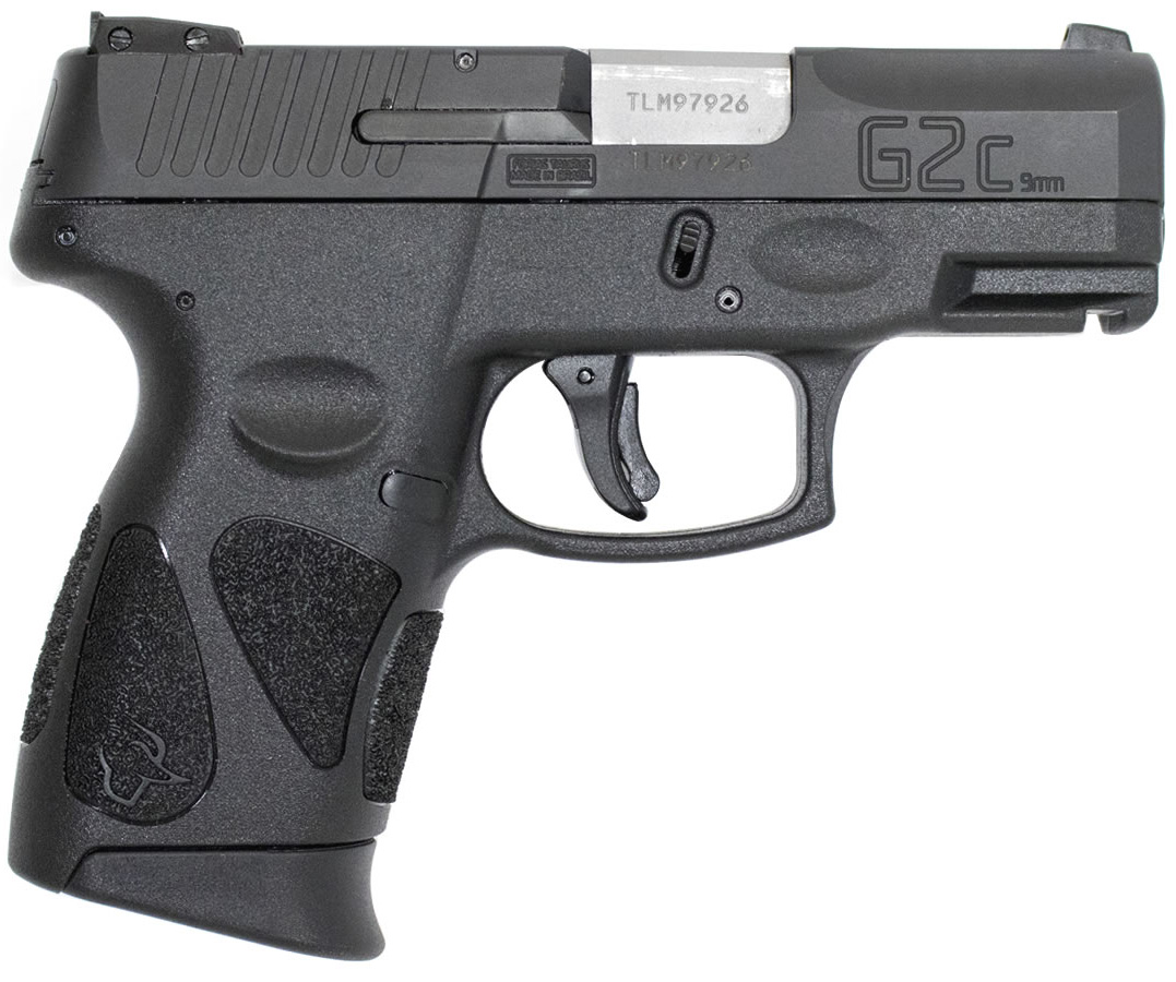

(After all the years I've been on this forum, I really don't know how I could have missed that there was a way to directly upload pictures. So, thanks for the replies.)
Here are a couple with the new trigger installed. I'm sorry I didn't take any of the process, but it was late and I was just trying to get it done. As you can see, the new trigger eliminates the "trigger safety lever" of the original. However, it made the feel much smoother, and from what I gather reading on other forums, eliminated a potential break point as the "lever" has broken on some folks here and there. The trigger I ordered and installed is KeepTinkering "Standard" model, there are others with different profiles to them (flat, more curved, etc).

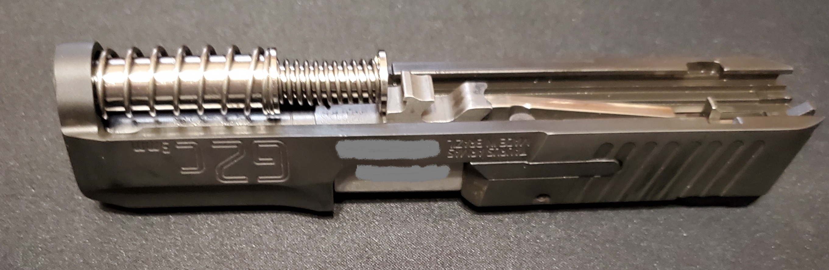

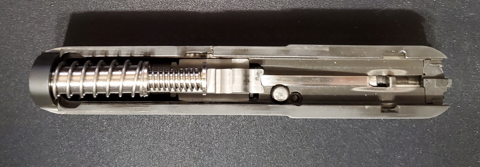

Well, last part to be replaced in this pistol will be the guide rod/recoil spring assembly. This stainless steel unit from Lakeline LLC (same company that made the replacement striker guide and sights) was a direct swap out for the original polymer guide rod/recoil spring assembly. The company also sells replacement spring sets and the assembly can be taken apart to swap out the springs if you were to wear them out. I'm going to go shoot this thing in a while, and I will add an update to this post with any observations versus the original guide rod/recoil spring assembly.
EDITED TO ADD:
So, I put a 50 round box of S&B 115 grain FMJ through the pistol as a function test. I slow fired the first full 12 round magazine. I then more rapidly fired 10 rounds in each of the other two factory magazines. With the three factory magazines, zero failures to feed or extract. I then used the 18 round Sig 9mm (for P226) that fits in the pistol. Out of the 18 rounds, I had two failures to feed, zero failures to eject. The magazine has quite a bit of "wobble" in the well, but it's okay for a range-only mag. I did NOT notice the pistol being any "softer" shooting or other subjective observations of that nature. However, being 9mm and of a reasonable size for a smaller carry gun, the recoil isn't anything serious anyway, just a bit "snappy" upwards at most. I did manage 42 out of 50 hits across my four steel plates at ~10 yards. I want to get some 124 grain FMJ to run through it, and to run a bit of +P through, as well. I'll make another update once I've done that.
