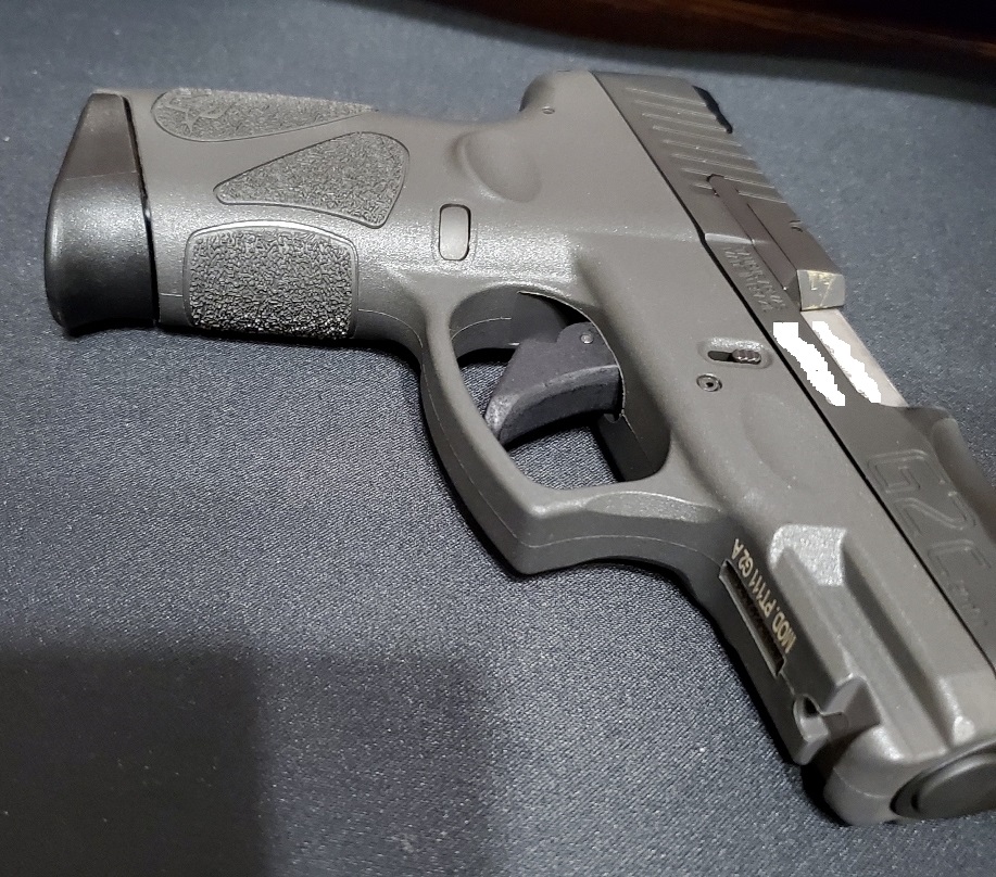

Here are a couple with the new trigger installed. I'm sorry I didn't take any of the process, but it was late and I was just trying to get it done. As you can see, the new trigger eliminates the "trigger safety lever" of the original. However, it made the feel much smoother, and from what I gather reading on other forums, eliminated a potential break point as the "lever" has broken on some folks here and there. The trigger I ordered and installed is KeepTinkering "Standard" model, there are others with different profiles to them (flat, more curved, etc).
