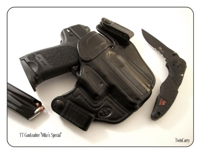

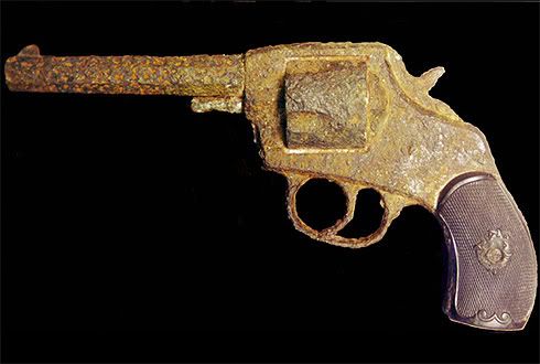

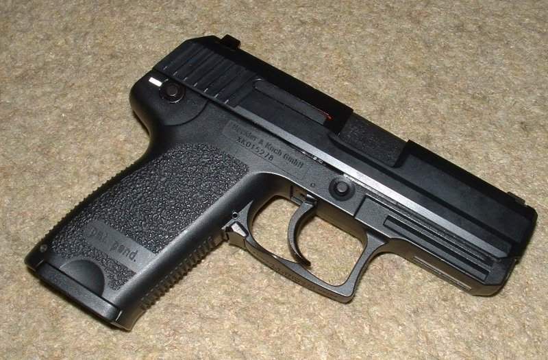

Should I worry about carrying my stainless steel guns in a black leather holster as far as staining up or just messing my the finish?
Will this
in this
turn into this
or this???
im half joking with the pics but am gunuinly concerned if whether a brand new solid black leather holster will mess up a stainless finish with extended sweaty carry.

If you carry it a lot, sweat on it extensively, and clean it rarely, you can develop spots of rust on the outside and you will almost certainly see rust on interior parts that can stay wet even when the outside has dried. The corrosion won't be anything like the picture of the revolver in your post and it will be easy to clean off without leaving significant marks if caught early. Periodic cleaning (I suggest at least once a week if you're carrying it regularly in hot weather) and wiping it down inside and out (bore included) with a lightly oiled patch or cloth should keep it looking good indefinitely.
