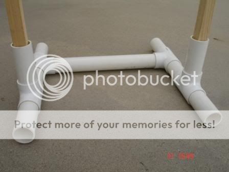

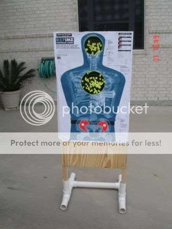

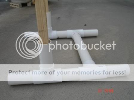

Not sure what you are looking for in target stands, but my range provides free 2 x 2s and plywood to make target stands and has a row of steel target stands in front of the berm, but the latter are all shot up. My solution was to make four target stands from 2" PVC. Do not cement the PVC pieces together so in case you shoot one it can be replaced... so far I have not hit one! The target stands can be placed in front of the berm for practice. They are really useful for engaging multiple targets while moving laterally, diagonally to the rear, etc. Another alternative is clay pigeons placed along the berm to provide some real challenge at the 25 yard line. So far my personal best was breaking three clay birds in succession at the 50 yard line while on my 2d CHL qualification with my Kimber TLE .45ACP. The newbies were impressed while I knew it was pure luck.
Here are some photos:
